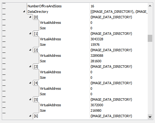

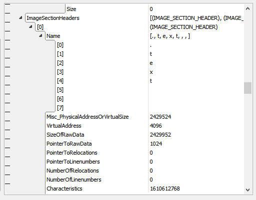

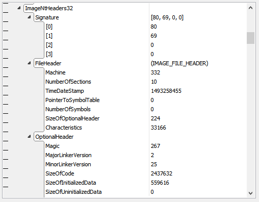

The pictures below show how this is parsed/visualized for my PropEdit.exe (but the solution is generic and works with any 32-bit PE file).
Re: Suggestion for HxD:User templates for data inspector
What is special (besides being able to define dynamic structures and automatically parsing files accordingly), are expressions like this:
Code: Select all
DataDirectory: IMAGE_DATA_DIRECTORY[:NumberOfRvaAndSizes];
As you can see in the fourth picture in the post above, the array size of DataDirectory dynamically depends on the field NumberOfRvaAndSize, which was defined earlier in the file, and is displayed accordingly. While with traditional programming language you would need additional code to handle the dynamic nature of the data structure, you can do it declaratively in HSD.
The position of ImageNtHeaders32 is dependent on ImageDosHeader._lfanew, which is a file-dependent offset/pointer and would also require imperative code in traditional languages. In HSD this declaration suffices:
Code: Select all
ImageNtHeaders32: IMAGE_NT_HEADERS32 @ :ImageDosHeader._lfanew;
The result can be seen in the second picture in the post above.
Code: Select all
ImageSectionHeaders: IMAGE_SECTION_HEADER[:ImageNtHeaders32.FileHeader.NumberOfSections];
ImageSectionHeaders is defined dynamically, as well. But in such a way that it depends on the two dynamic declarations before (their size and position, that depends on sibling/previous fields). This is because ImageSectionHeaders is the third field in OVERALL_FILE and the preceding fields are of dynamic size, so the position of ImageSectionHeaders adapts accordingly. The size of ImageSectionHeaders is also dynamic, as can be seen when looking at the identifier between [ and ].
