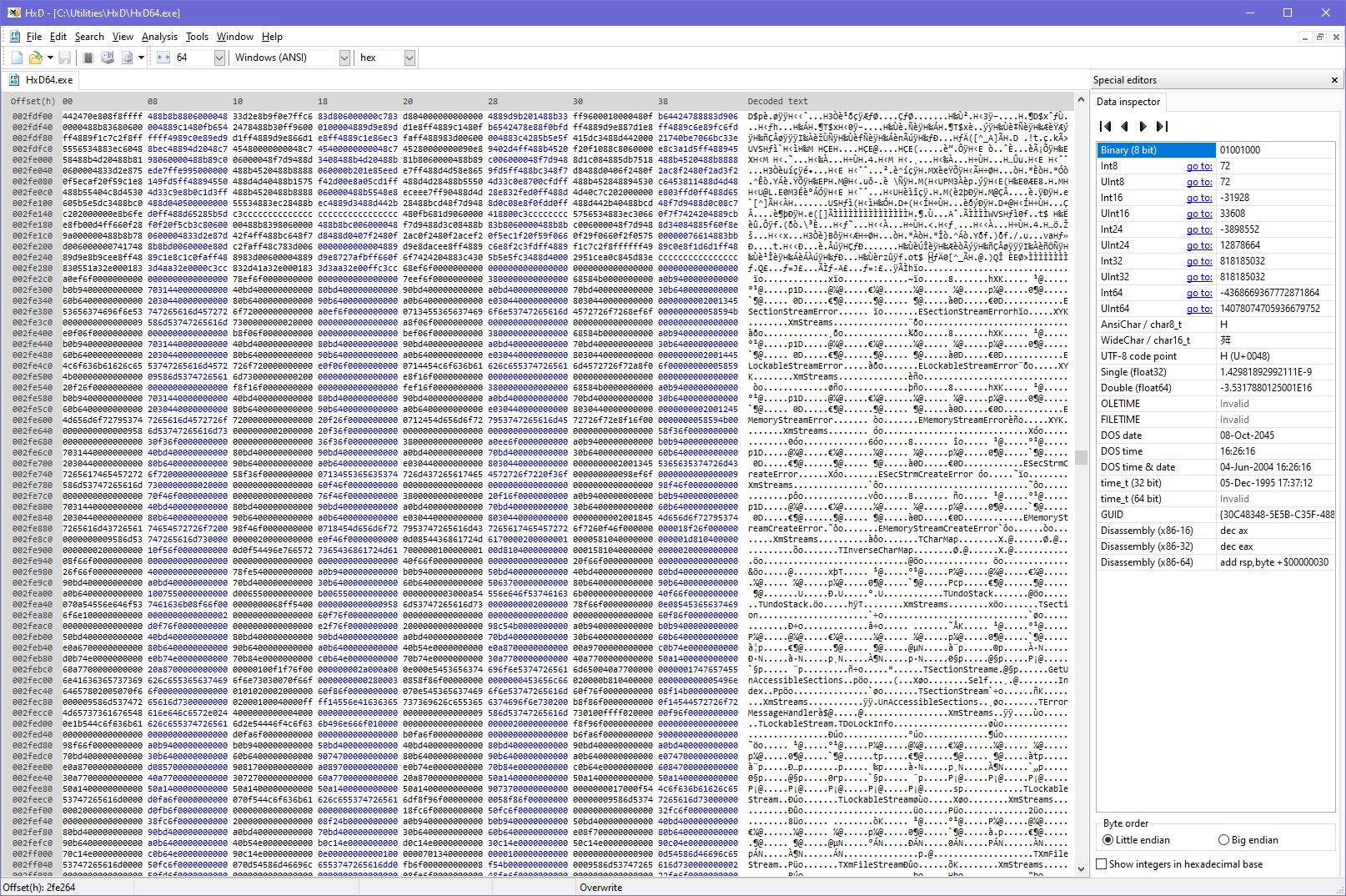

I'm working with fixed sized binary records, it would be great if HxD could have a banded highlighting of some sort.
For example, specify the 'band size' and background color - so HxD might alternately highlight blocks of 256 bytes.

- Attachments
- Example
- bands.png (8.16 KiB) Viewed 32336 times

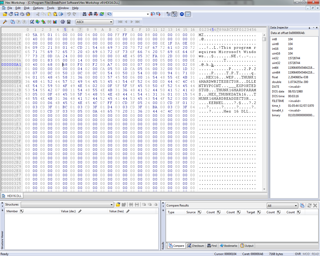

Worth looking at Hex Workshop's view (attached).
Where the cursor is currently at, the column and the row number is highlighted in blue.
Where the mouse pointer is (not on the screenshot) the row and column numbers have darker (grayish) background, which is also reflected on the text panel.

Re: Background Colors
Also it will be nice to colourize/alternate colours in a selection. Forgot to mention in the previous post that alternating colours (whilst not selected) would also be a very nice to have as it pleases the eyes. Having moved from Hex Workshop, it's feels somewhat dull in HxD now.
- Attachments
- Hex Workshop 2.png (2.85 KiB) Viewed 32065 times

I just downloaded this hex editor and it looks really great! (I especially like the data inspector!).
I have the even and odd columns (of 8 bytes each) differently coloured (great!), but for some reason only the hex part is alternately coloured. How do I apply the same colouring to the text (decoded) part?
