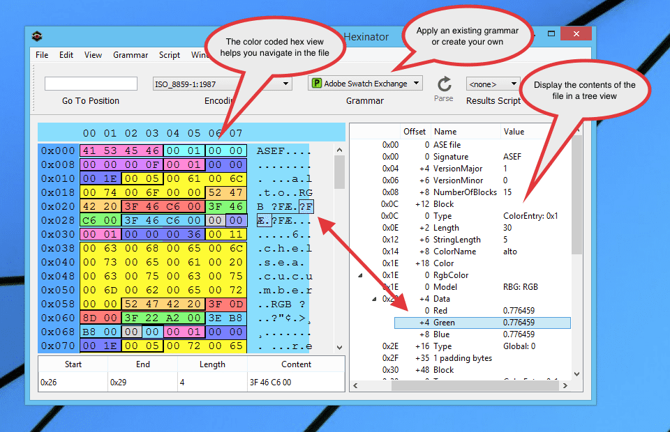

Suggestion for HxD: Blocks Tagging
Post by MarcosG »
I think it would be very useful to have the possibility of labeling sectors of the binary with different colors and a text that identifies each one. I think it is a very necessary option for binary analysis.
The idea is basically to be able to select blocks and put a color label on them with a simple text that identifies that block. It would be nice to be able to select the background color and the font color. And of course, being able to save these labels in a file parallel to the one analyzed.
And in the right panel there could be a list with all the tags and quick access by clicking on them.
Something like this:
Image taken from Google.
I would love to see this option in new versions. I really think it's very useful and I didn't find a tool with the convenience of HxD and a labeling option.
I greatly appreciate the work you are doing and I congratulate you on the position you have achieved.
Greetings!

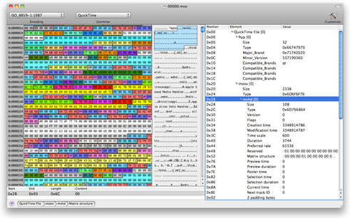

Re: Suggestion for HxD:User templates for data inspector
The screenshot in the post above comes from the software at synalysis.net, which has a Windows version at hexinator.com/benefits.
A higher resolution screenshot from this software that shows more detail:
It uses "grammars" defined in XML which is quite verbose, and not easy to read or edit manually, for example for BMPs:
