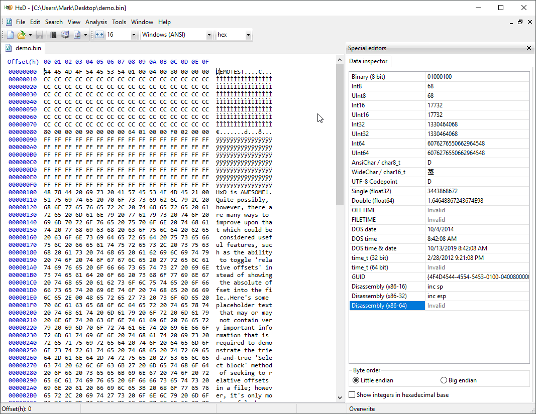

Until something like this gets implemented (if ever), you could try using my method of seeking to relative offsets:
  1. Place the cursor at the beginning of the structure.
  2. Press Ctrl + E to bring up the 'Select block' dialog.
  3. Tab twice to the 'Length' input box.
  4. Enter the relative offset to the data.
  5. ???
  6. Profit!
Obviously you'd need to keep track of where the beginning of each structure is if you need to move the cursor at all, but typically if I'm checking multiple fields it's just a matter of adjusting the amount of selected bytes. Hopefully that makes sense.
