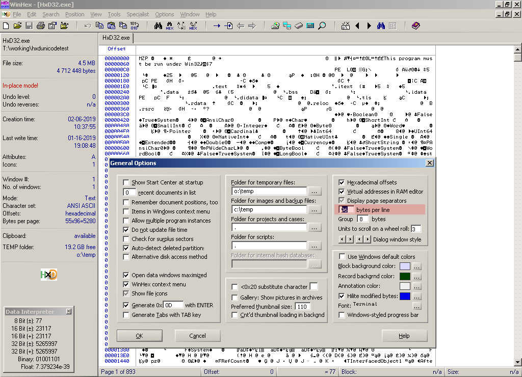

WinHex does follow the bytes per line setting. Odd is that it has a single shared setting for both the text and hex modes. If text mode is active, the setting is shown as "64"
for typical bytes per line of 16, and can be adjusted.
In Total Commander, one can specify line width separately for text mode (called "binary"), which is easier to understand, and one can switch between hex and text pressing "2" and "3", which are faster to reach than mouse.
I am used to this mode, and probably don't find it bad design for this reason. It avoids odd line widths that would break up data that is in groups of even number of bytes (such as 4), and lines that are too long for reading (tops 80 to 100 characters) in a maximized window. And if one wants to make the window wider, he only has to change one setting. But changing two is fine as well.

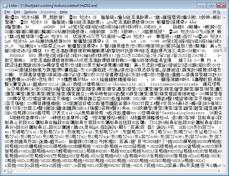

For future Unicode decoding, please try to avoid showing symbols from Windows font substitution in Vista/Seven+, which result in cluttered and slow scrolling view:
