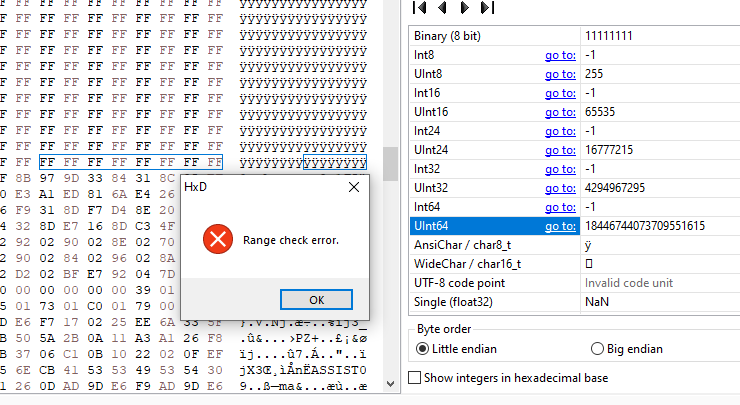

PS. One small observation while I was playing with the "go to" links. I get a "Range Check Error" dialog in the case of a Uint64 $FFFFFFFF.
Ideally this should be trapped and instead the consistent Informational dialog presented "The file does not contain..."
Thanks for the report. But I have not been able to reproduce this error, with the 2.4.0.0 English release version.
What is the file offset and file size? Or can you share the file itself? It may be the error is not related to the goto.
I am using 2.4.0.0 on Windows10 Pro.
I've attached the file. It is simply a 4KB ROM image where the first half is blank (FF).
I get the error at any point where the Uint64 comprises 8x FF bytes. ie. The maximum Uint64 value.
The first point it does not error is when positioned on the 7th FF prior to the mid point.
ie. FF FF FF FF FF FF FF 30 byte sequence (or $30FFFFFFFFFFFFFF little Endian).
Hopefully you can re-create the error.
ASSIST09_2732A.zip
(2.03 KiB) Downloaded 4058 times
Re: Disassembly feature as a 3rd party extendable plug-in?
I can reproduce it now. It only happens in the 64 bit version, and it makes the debugger hang and sometimes crashes the IDE.
Edit:
Ok, was merely a question of using an unsigned type instead of a signed one. Interesting that it caused such a havoc for the IDE and debugger, but only under 64 bit.
Fixed here:
https://mh-nexus.de/downloads/HxDPluginFramework.zip
Could you please test the one change in the plugin-framework, for making proper readonly plugins?

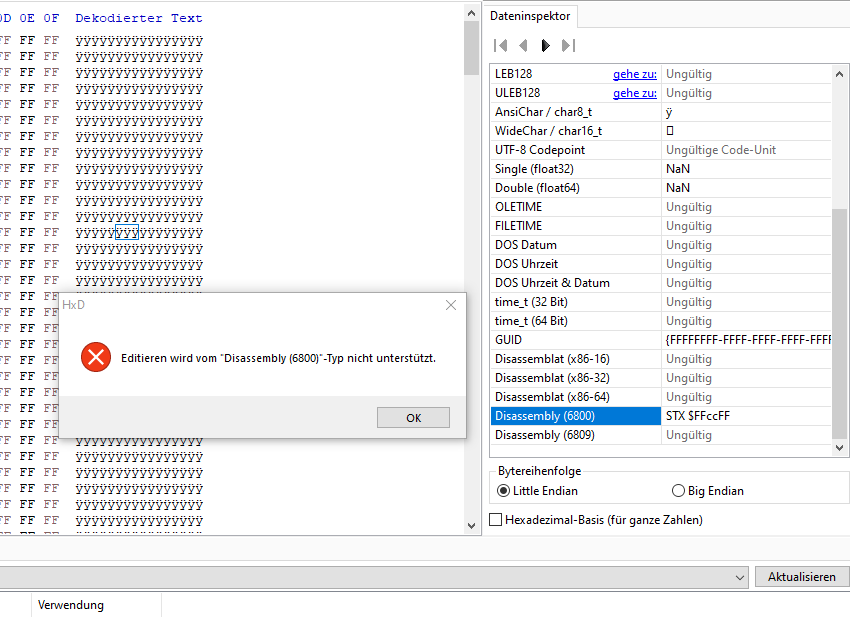

Maël wrote: 10 Nov 2020 17:34Could you please test the one change in the plugin-framework, for making proper readonly plugins?
Yes, my apologies for not getting back to you sooner. Tests now successfully completed. :)
1. Read-only Plugin option to inform of edit rejection (FSupportsStrToBytes):
Which Google translate tells me is appropriately (in English): "Editing is not supported by the "Disassembly (6800)" type."

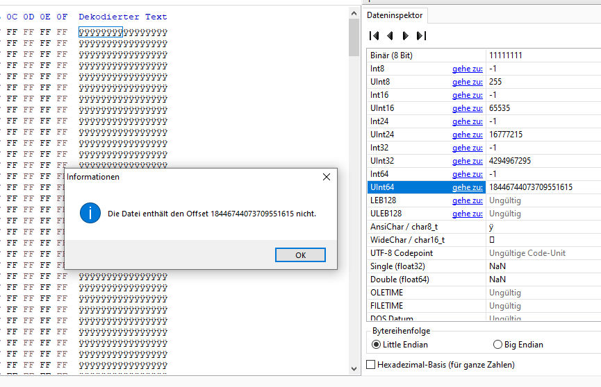

2. Your fix for the Range Error (Uint64 go-to for FFFFFFFFFFFFFFFF):

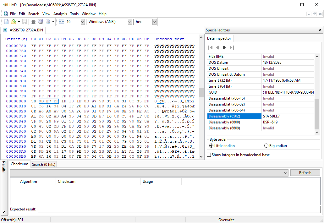

UPDATE: Committed to github an additional definition for 6502 Disassembly. As below:
  • Added original 6502 Disassembly definition file (Dasm6502.csv), and associtaed .ini file settings (to enable).
  • Note this is the first Little Endian CPU definition, which confirms successful Little Endian Operand operation.
  • The 6502 definition file can also form basis for later addition of extended instruction 65C02 and 65C816 definition files.

Screenshot showing correct Little Endian 6502 Absolute addressing STA instruction decoding:
