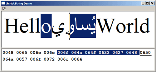

The non-straight forward relation between bytes (in hexadecimal) and Arabic text is shown nicely here: https://www.catch22.net/tuts/neatpad/in ... -uniscribe

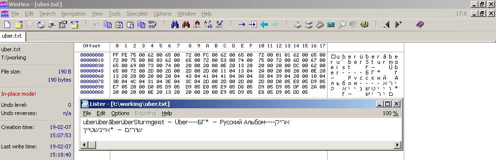

Re: Text column support for UTF-8, UTF-16 and other multi-byte text encodings
Post by j7n »
I have a Western-centric view on Unicode and feel that most of the complexity that comes with foreign scripts is not necessary in a hex editor. A "unicode 1.0 lite" would be enough (and maybe more useful). Text editors/viewers that can load 'binary' data and synchronize with any text inside it exist and can be used instead.
When it comes to characters that combine into one, such as "u" followed by a "combining diaeresis", it is more useful to see the two codes separately than a restored letter "ü" (most strings would already have Latin letters precomposed). Any invisible control characters are useful to see without interpretation, such as writing direction marks. Writing direction marks (which can occur randomly) shouldn't affect how a selection with the mouse work. This allows to diagnose problems when those symbols occur in codes like filenames, which look ordinary in complete text views.
For example, in WinHex I see a very basic Unicode. Maybe it is upgraded in later versions, but aside from glitchy graphic rendering, extra spaces and inability to select a font, this is sufficient. Combinining diacritics are not reconstructed. Writing direction marks are shown as arrows and not followed. Drawing a selection over the hebrew text in the text column behaves as over any other bytes (quite frustrating in a text editor).
I guess, with UTF-8, you would have to read back a few bytes before the current offset, and invalid characters can't be avoided on binary data.
Sorry for repeating some of these points (and not using image attach). I will stop now.

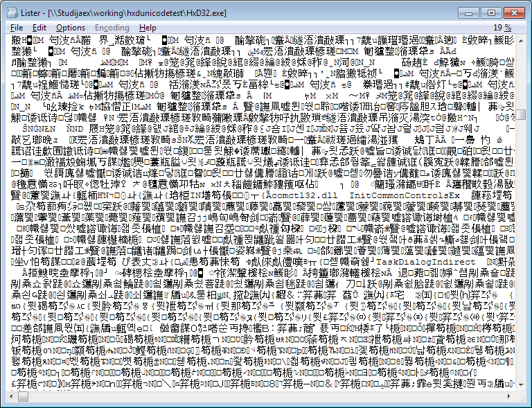

Thanks for your feedback (and attaching images).
Notepad++/Scintilla has a rather consistent selection behavior (always the same direction, no changes for RTL text), yet also renders RTL text in the right order. This would probably be ideal, yet of course it would require parsing ahead (possibly indefinitely, depending on file size/length of the RTL text).
Lister seems to be buggy when selecting. I am also not sure what the criterium is for the line break.
I could not see any in your example (though the font is quite small). Do you have any?

When rendering text, complex layout and bidi text should be disabled. Only left-to-right printing (also for Arabic or Hebrew) should be used and complex layout rendering disabled, so that individual characters are printed so that strings of characters can be split up over several lines, with a consistent look.
https://en.wikipedia.org/wiki/Complex_text_layout
Equally text fields should render text the same way (no complex text layout or bidi support) to have the most predictable behavior.
This should be acceptable, since complex script layout is about ligatures and contextual shaping of graphemes (which makes a script harder to mentally process without additional training, not easier to read, but looks "prettier"). Diacritics and other combining characters however are never written separately in normal language use, and will feel unfamiliar.
A remaining issue though is rendering of RTL languages in LTR order. This is probably confusing for speakers/writers of those languages. But it will be difficult to implement RTL correctly, when it's not always clear where a string starts. There can be Codepoints that change the LTR order to RTL (which affects where punctuation marks are actually printed, for example) and there may be incomplete strings in this currently visible portion of a hex view. So RTL rendering of a chopped off string might look confusing and change as we scroll. Fixing this would require to parse beyond the view limits, and possibly even far beyond, thus affect performance in quite unpredictable ways, depending on text.
Since text editors basically parse a file from start to end, or at least line start to end, this is less of an issue. But a hex editor cannot rely on such delimitations to be present, which means that, in the worst case, the entire file has to be analyzed; and in the the not so seldom case, it can still be quite a large portion of the file.
So for now LTR will be used for all strings, and we will see how much of a limitation it is.
